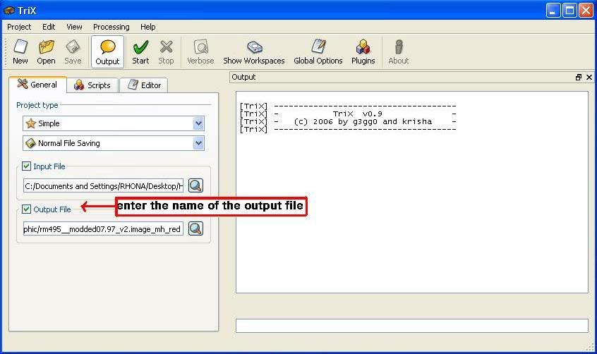

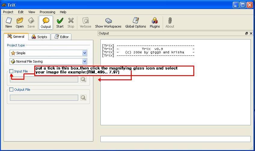

then extract po natin ang "TriX.exe"

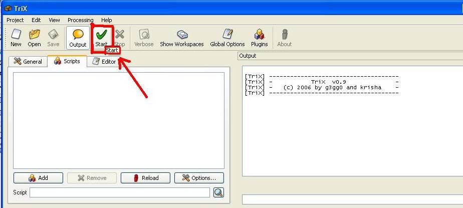

then run this application and follow
the two screenshot below...

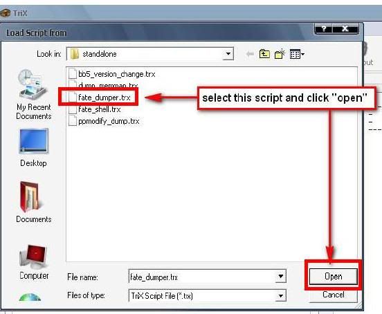

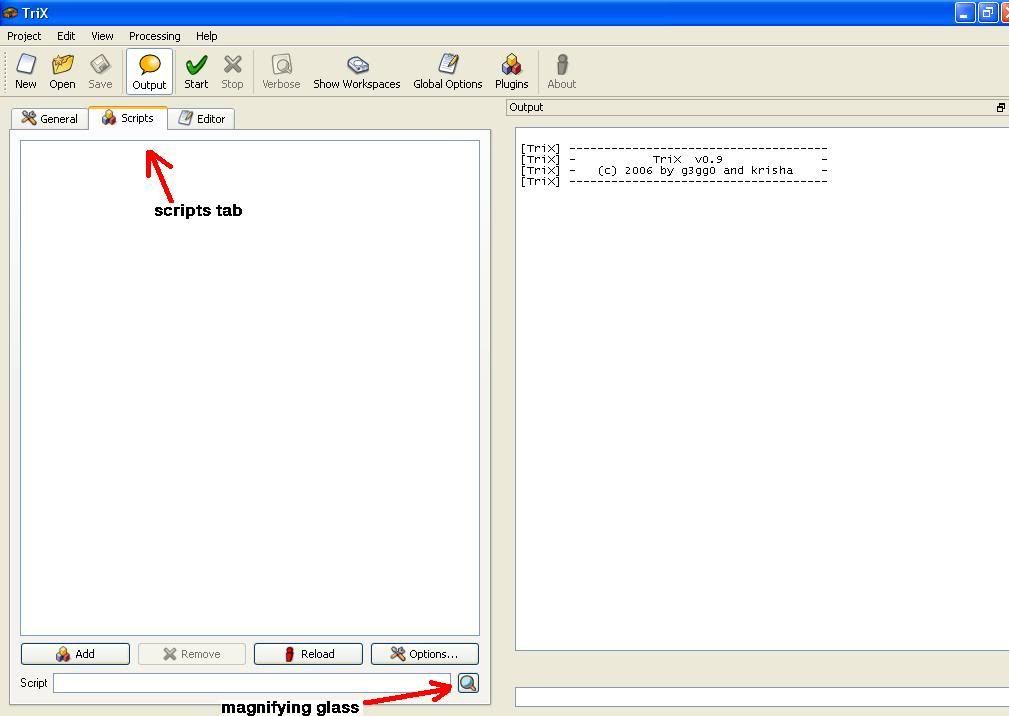

Now,switch to the scripts tab and click on the magnifying glass icon
Then select the “fate_dumper” script and click open

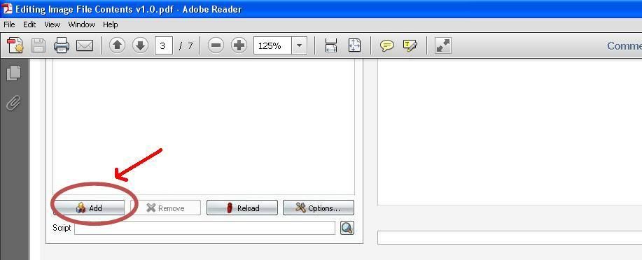

click "add"
Then click the "start" button

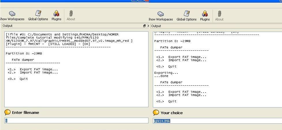

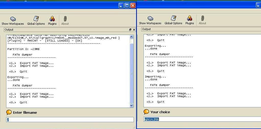

now, look to the right side of the program screen. You should see the
below screenshot. In the “Your Choice” field enter 1 and press enter
to export the content. It should ask you to enter filename. Enter a
name of your choice but note that the extension should be “.IMA” …
example: “light14.IMA” then press enter….
please...DONOT close the program

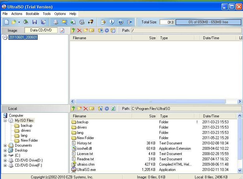

Minimize it... and "open" UltraISO.....

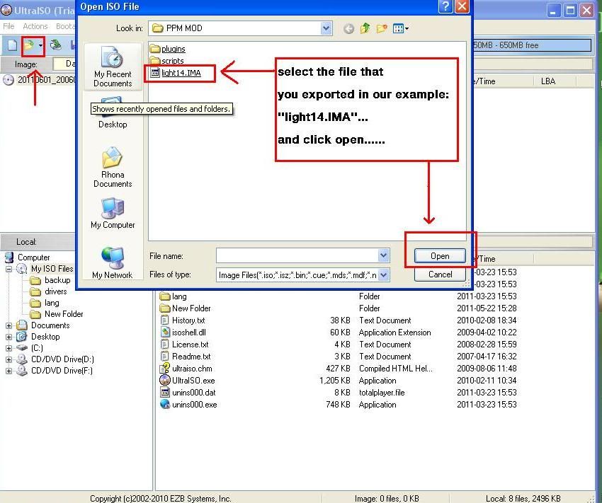

Then click file >open and goto the TriX folder and select the .IMA file
that you exported.
Great! You should see this window… Here is where you edit the
content file.
Return to TriX and then in the “your choice” field, type 2 to import
the image and then press enter. Then when it says “enter filename”…
enter the name of the “.IMA” file example: “light14.IMA” and then
press enter… wait and it should say done…

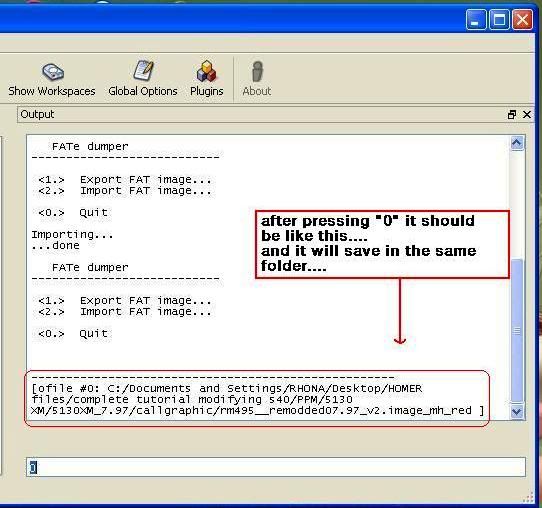

Now the last step to save your new image file is to type “0” in the
“your choice” field to quit…. Wait ten seconds
